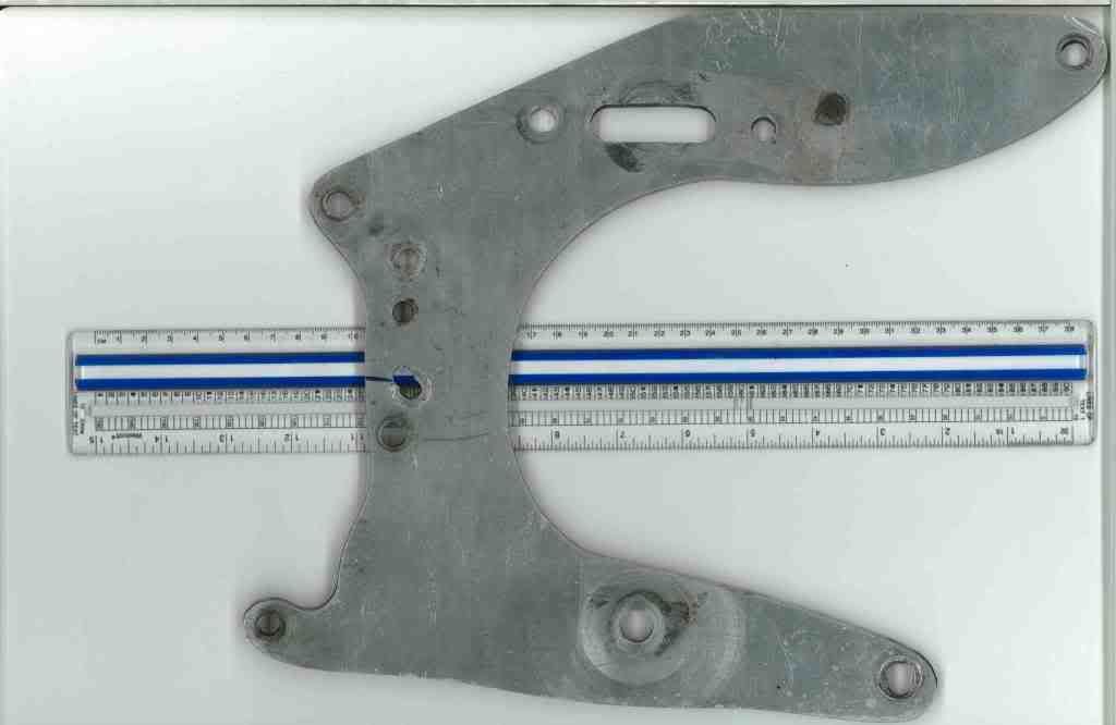

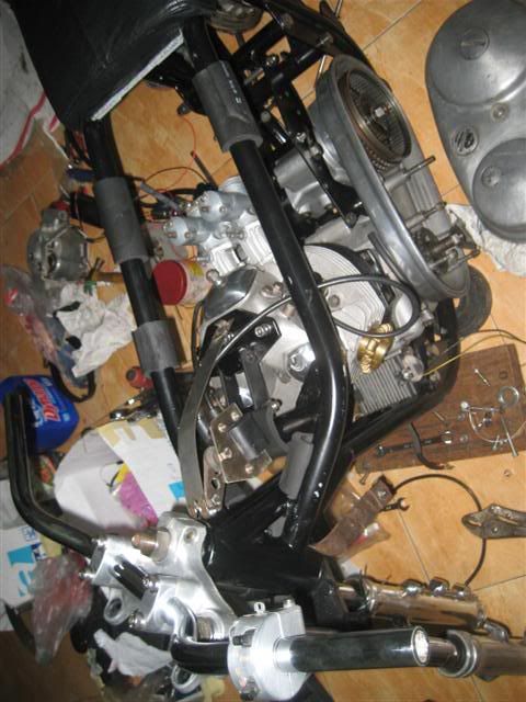

I'm Amran from Klang, Malaysia. My café is all about Young at Heart (YAH), straight forward project because it just putting of the 1972 Norton commando engines (Young heart) in 1957 Wideline featherbed frame (Old body). Being my first cafe project, I simply did not know where to start. Few questions need to consider and answer in this project: Am I looking for cafe in all the right places? Should I look up the original vs Café? New parts is…money? because the more you put together, the more it want to done. My enthusiasm vs my ability? So, after I get motivated by Kenny Cummings from New York City thing just move slowly..but surely i hope
Many thanks also to Kenny (http://www.shelbynyc.com/nycnorton/74Commando.htm) for sending me his engine mounting scan photo for a kickoff my YAH project. Really appreciate it.
Attached herewith some of my bikes project for sharing. Hope somebody out there, who love play with tools and dirty hand to share your interesting story about your cafe project etc.
Frame: 1957 featherbed frame painted with Hammerite black satin
Others: Local made steel central oil tank & gas tank..
Motor: 72 Commando 750cc engine
Gearbox: Modification of AMC gearbox with longer commando mainshaft etc.,

So..being NKOTB and not 'financial sound' man,my concept is also straight forward,
Just used things that less cosmetical but practical..such as nippon or home made things.
My junk for your
Front end
Standard Suzuki GS550 Hub and disc brake
Standard Suzuki GS550 front fork & brake calipers
WM3 Sanremo Italy Alloy rim with custom spokes
Home made headlights brackets to support 1930 Lucas car's 8'' headlight..
Yamaha clutch lever..nippon
Yamaha brake lever with standard master cylinder…nippon
Yamaha clip on handle..nippon
Rear end
Standard Suzuki GS550 Hub & custom sprocket..zen idea, TQ
Nippon shocks…
