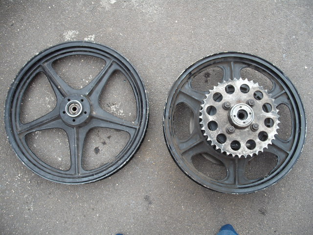

Here with the story so far. I was up at the workshop yesterday Friday 4th Dec and took a couple of snaps. I have included the wheels I will be using. I'm not sure who the manufacturer is but a good find I think. Thanks to Bryan Jones. I am not doing the engineering and customising on this that is down to my mates brother Rob. Also a mate by now. Thanks to my pal Jerry for the loan of the trailer.

Do not know the maker of the wheels you intend to use, maybe somebody else will recognize 'm bounce
Wheels
Post  warthog1959 on Sun 6 Dec - 4:28
I sent the wheel pictures to Carpy and he say's he has a pair and that they are UK made Melbur's. but I could not find anything on the internet to verify this. Obviously he is very Knowledgeable, but there are a few similar wheels on various variations and varieties. such as this 1976 Dresda. But the rear has 5 spokes and mine has 6. (I thought I was almost there)

Wheels
Post  TWINFIN on Wed 16 Dec - 11:45
They might be one of these wheels (the photos are of CB400-Fours though) :
My guess is CMA cast wheels:
but they could be E.P.M. magnesium wheels from Italy:
some other possible brands were Morris and another called Lester.
If they are magnesium you might want to have them magnafluxed for cracks just to be safe.

Progress has been slow so far, but only by choice. It is mainly because of my late decision to go with spoked wheels and that took quite a bit of sourcing and restoration. Now that part is done (Honda Gold wing front end and Cb750K 1976 rear wheel) Rob is underway

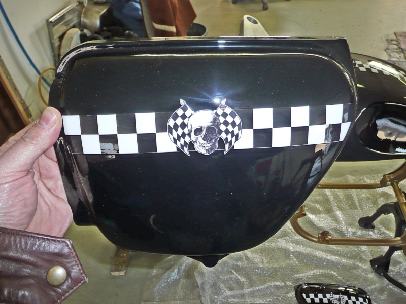

Took a ride up to the workshop today and Rob is making good progress, but say's there are still not enough hours in the day. Lower part of the engine is now reassembled with new crank and big end bearings. Case is painted Titanium silver. The Billet Yoke, clock bracket, clocks and idiot lights have all come together very nicely. Rear lights have been fitted direct to the seat, we thought there would be number plate issues if we fitted the light to a 'fender'. Doesn't look half bad. Front Calipers in place, they were black, now shiney alloy with new piston's. Rob has made a fibre glass seat pan to accomodate some foam and vinyl that we can velcro to the main seat body and still have access to the glove box and battery. Rob has taken some more detailed shots of the progress, but here are some pics of the build as it progresses. Note though the 'trip mileage' on the clock. What with the skull decal it's a bit spooky. Maybe Rob is having me on.

Rafe56 wrote:nice, real nice to say the least.
I have a question tough, the crankcases look great. Is this the result of sodablasting???????
Me and my buddies are gonna build such a blaster so that might be a solution for my engine.
gr Rafe,
The crank case in the latest photograph is painted with Titanium VHT. The earlier picture is the engine after Soda Blasting and before painting. This engine was originally painted black. The dark spots on the crank case were corrosion, which were rubbed off with a polishing wheel before painting.
