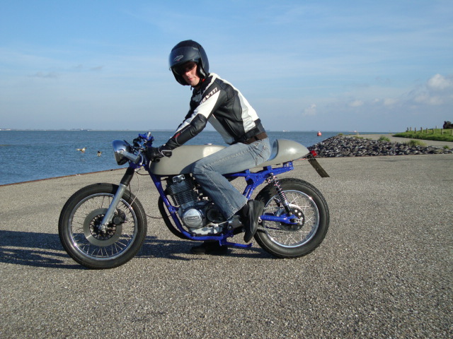

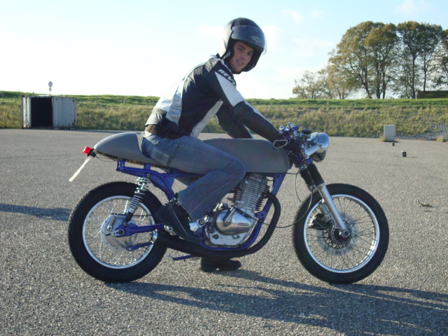

Post  alazzurra 550 alu style on Fri 22 Oct - 18:14
hi guys, today we made the first serious testdrive,
here some pics of gerhard on the gn.
she's running perfectlyn by the way!!!!

Post  sven on Fri 22 Oct - 21:30
Very good looking bike! I'm looking forward to see the final result!
Good luck!

Re: suzuki gn400 single cilinder caféracer by gerhard and rien
Post  MIOB on Sat 23 Oct - 17:39
Nice!! You figured out what color you're going to apply to the tank and seat yet?

Post  MIOB on Sat 23 Oct - 17:40
By the way: Are you sure you're clutch cable wont hit the exhaust and melt?
