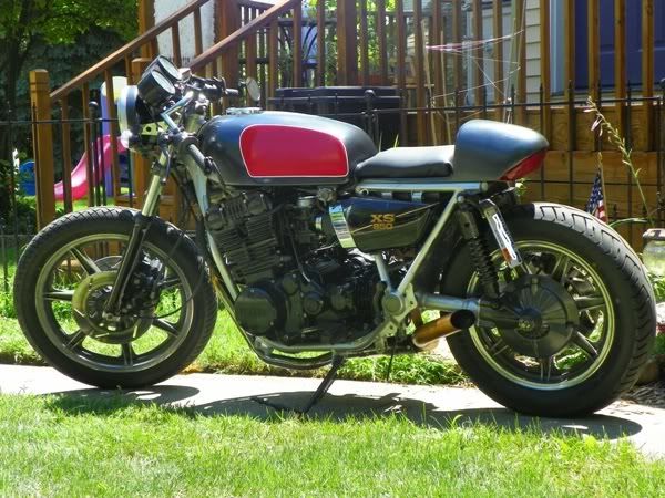

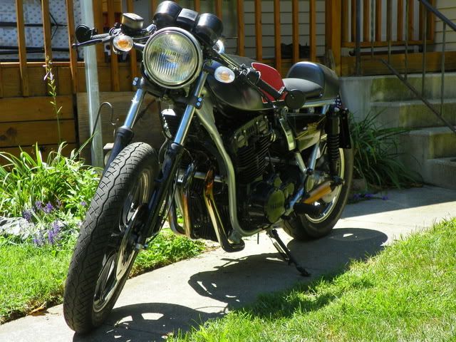

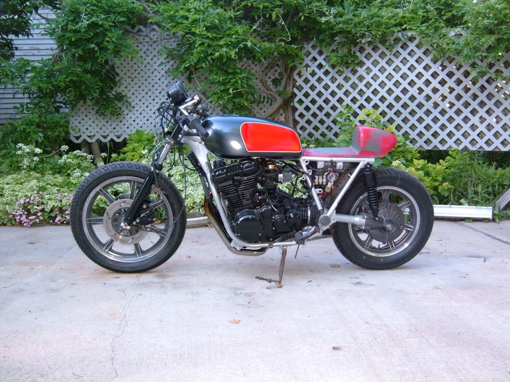

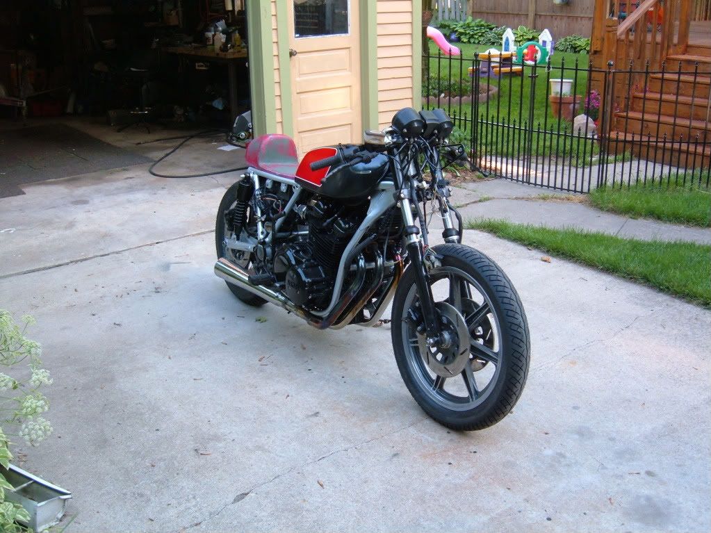

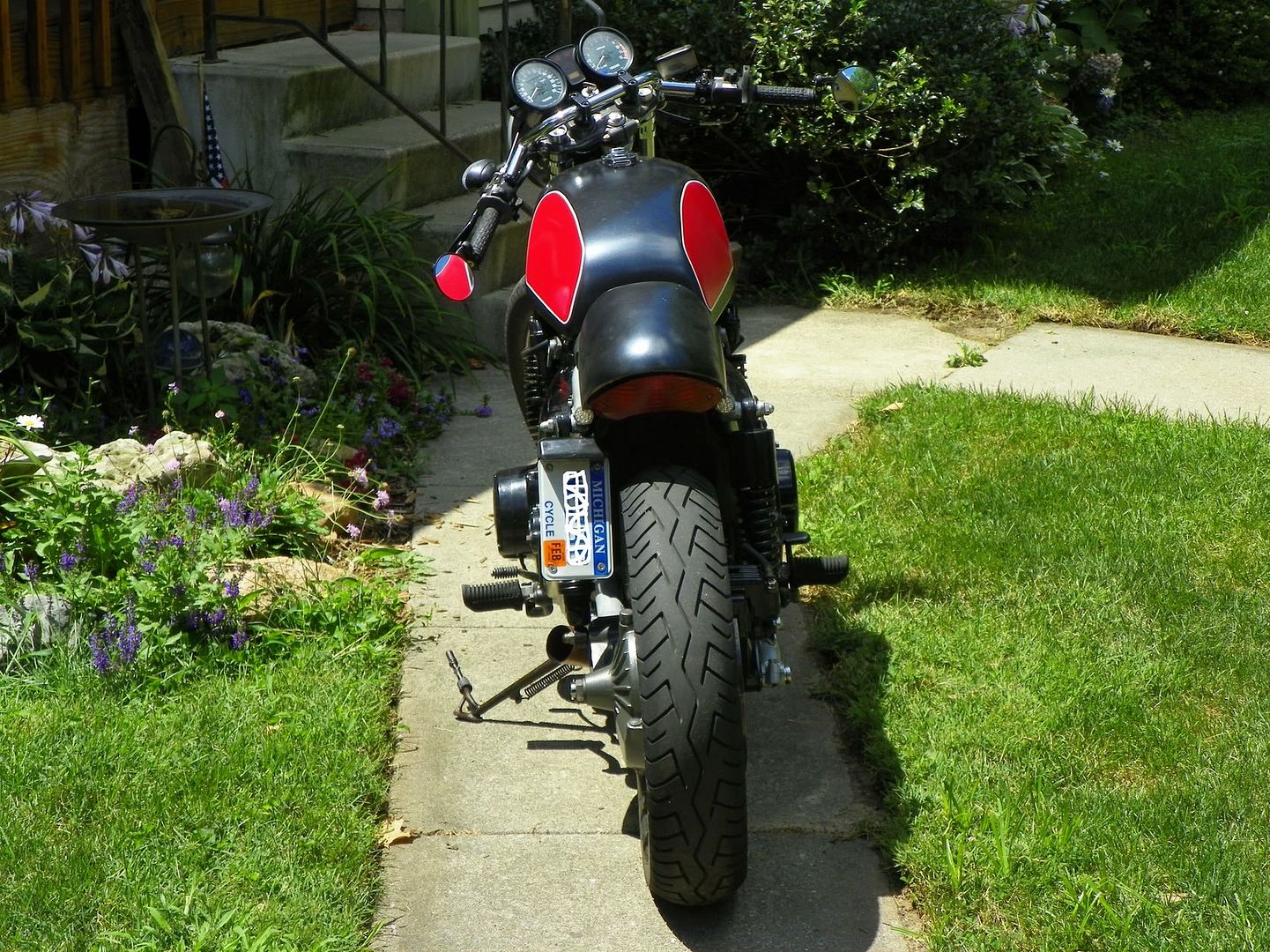

This is my XS850 I got for free last summer. It was a total basket case and needed some love. I wanted a Honda CX500, but what the hell, this was free. I had to do a complete tear down on the bike and learned a lot in the process. I really like the Yamaha triples (XS750/XS850) and would like to give another one the cafe treatment. Although my bike is not quite finished yet, I feel it is ready to show off a bit.

Post  kinematica on Fri 4 Jun - 1:49
The whole bike was painted with a spray can. I wanted to powdercoat the frame but I really didn't want to spend the money. The frame was painted with duplicolor wheel paint and then clear coated, the engine has a couple coats of high heat (500 deg F) gloss black and the body work is wearing duplicolor exact match automotive paint.

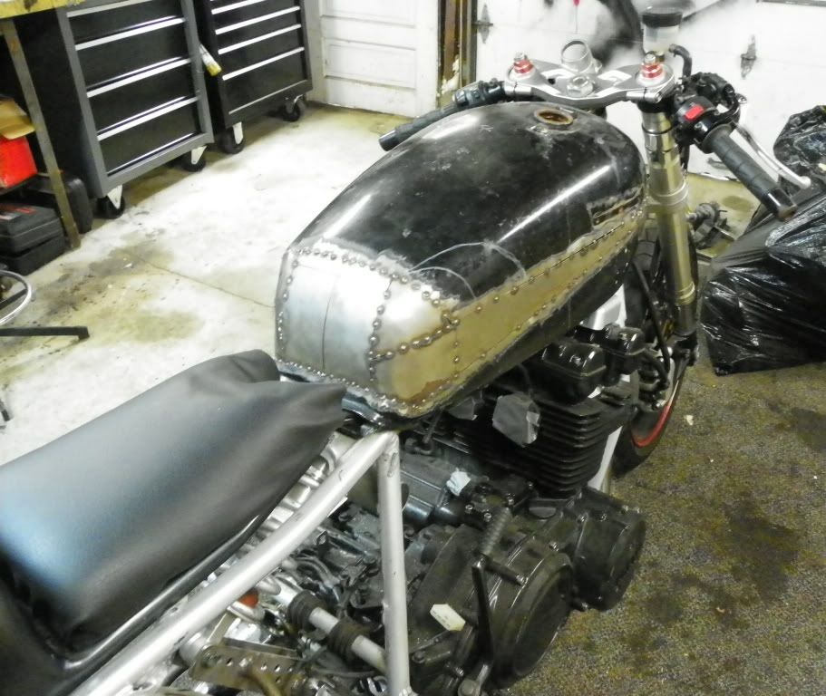

Re: 1980 XS850

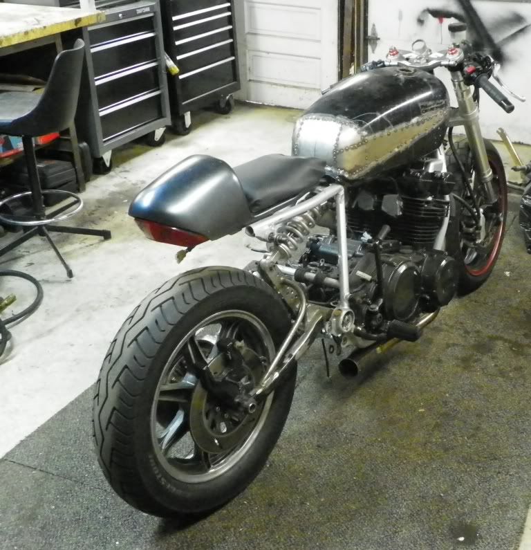

Post  kinematica on Wed 13 Jul - 3:15
I have totally stripped my bike again and started the next phase. The front end is from an 05 Kawasaki ZX6R. The rear mono shock is from an 06 Yamaha R1.
The original tear drop gas tank was split in half and expanded to make room for the new battery location under the tank. All the electronics will find a new home under a new tail that I will make from fiberglass. It is far from finished, but it is looking good.

Post  kinematica on Sat 30 Mar - 1:42
kinematica
Posts : 17
Join date : 2009-12-07
Location : USA (Michigan)
Re: 1980 XS850
Post  kinematica on Sat 11 May - 20:50
Finally finished fabricating the swing arm and put the ZX-6 rear wheel on. I really like the way it looks! The 180 tire makes a huge difference.
