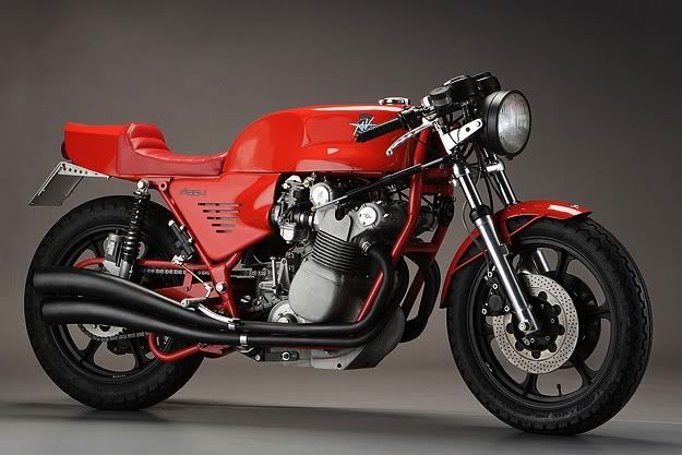

My inspiration is a MV like on the picture, black and red. Like a real caferacer I will keep it as simple as possible.
The inspiration is a MV, but I will not try to make it a MV replica.

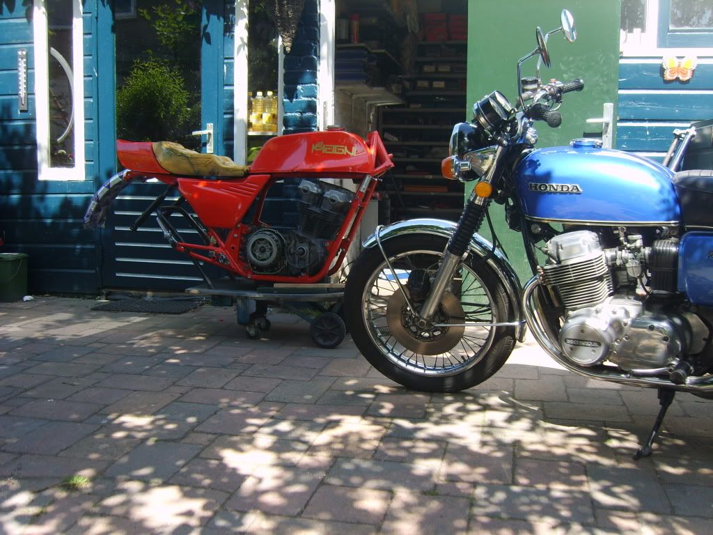

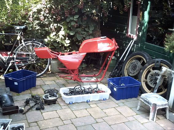

Post  Hank on Thu 16 Dec - 21:57
An update of the building of my Magni Honda 900.

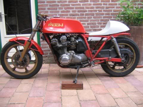

In september I painted the frame, the wheels and the engine of the Magni. Last winter I rebuild the engine, the only thing I have to do now is make the covers look good. I'm not sure about the colour of the engine-covers. Maybe I glass-blast them like on my Yamaha or paint them matt-gold ?
At this moment I'm very bussy with all the small parts. I want to finish the glass-blasting and polishing before spring, then I can start the nicest part, the rebuilding !

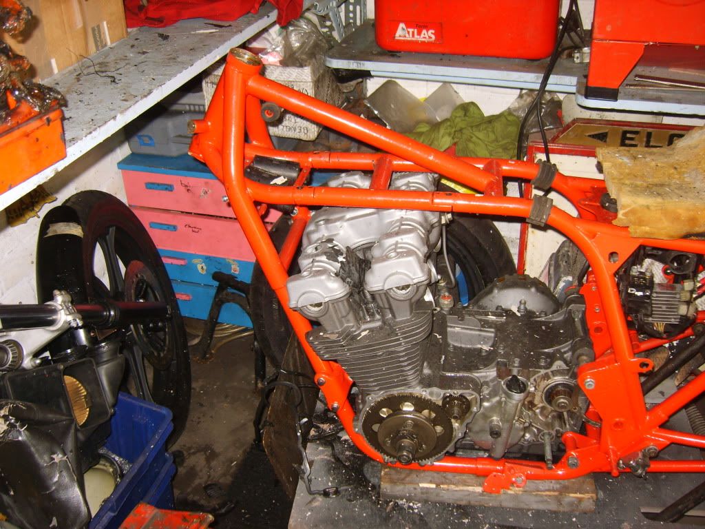

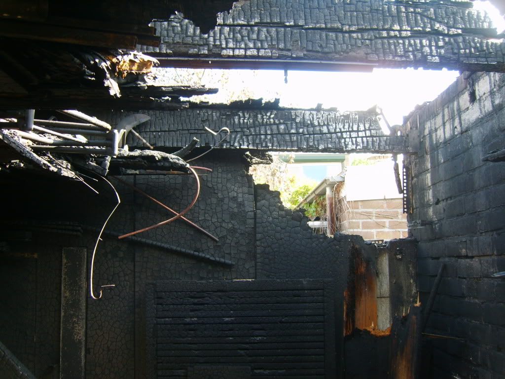

What a bad night, from friday to saturday an idiot was so kind to burn down my shed. Lots of( happenly ) Honda parts of my Magni were lost in the fire. The engine is having a lot of water damage, so I can start all over. I'm glad the Magni patrol tank and sidepannel were in my house.

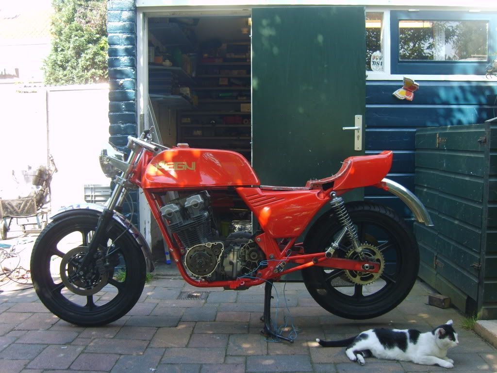

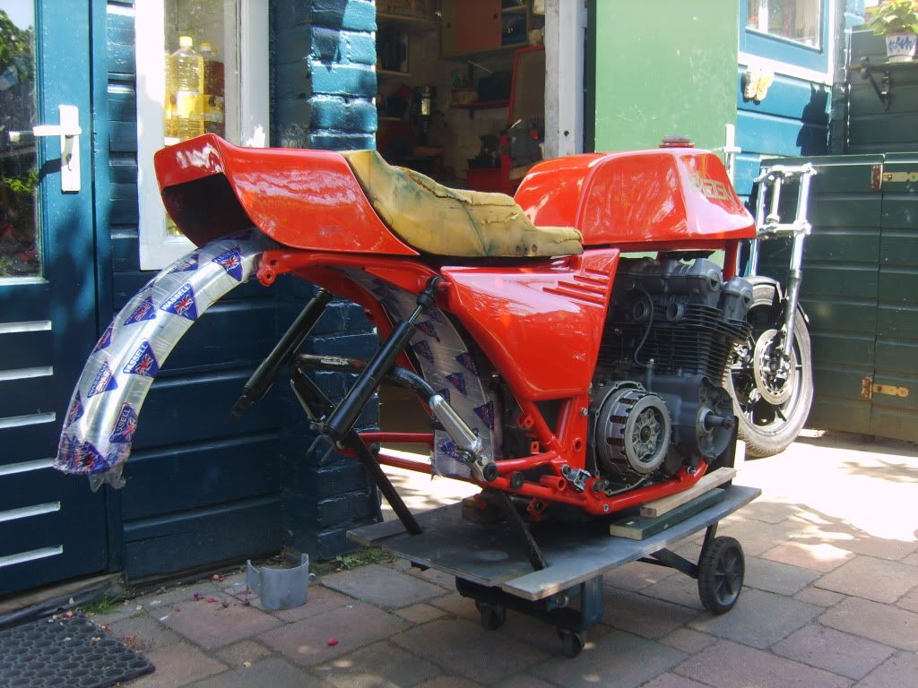

A company has dried al my stuff that was getting wet whit the fire. I've got my Magni back a few weeks ago and started with getting some wheels in it. At this moment I 've got the idea how I want to built him. I made a seat pan and found an adres for Suede, to make a sadle like the MV's.
Now I take some parts of to make them fit.
The pictures give an idea how the bike will become, but don't think it's almost finished.

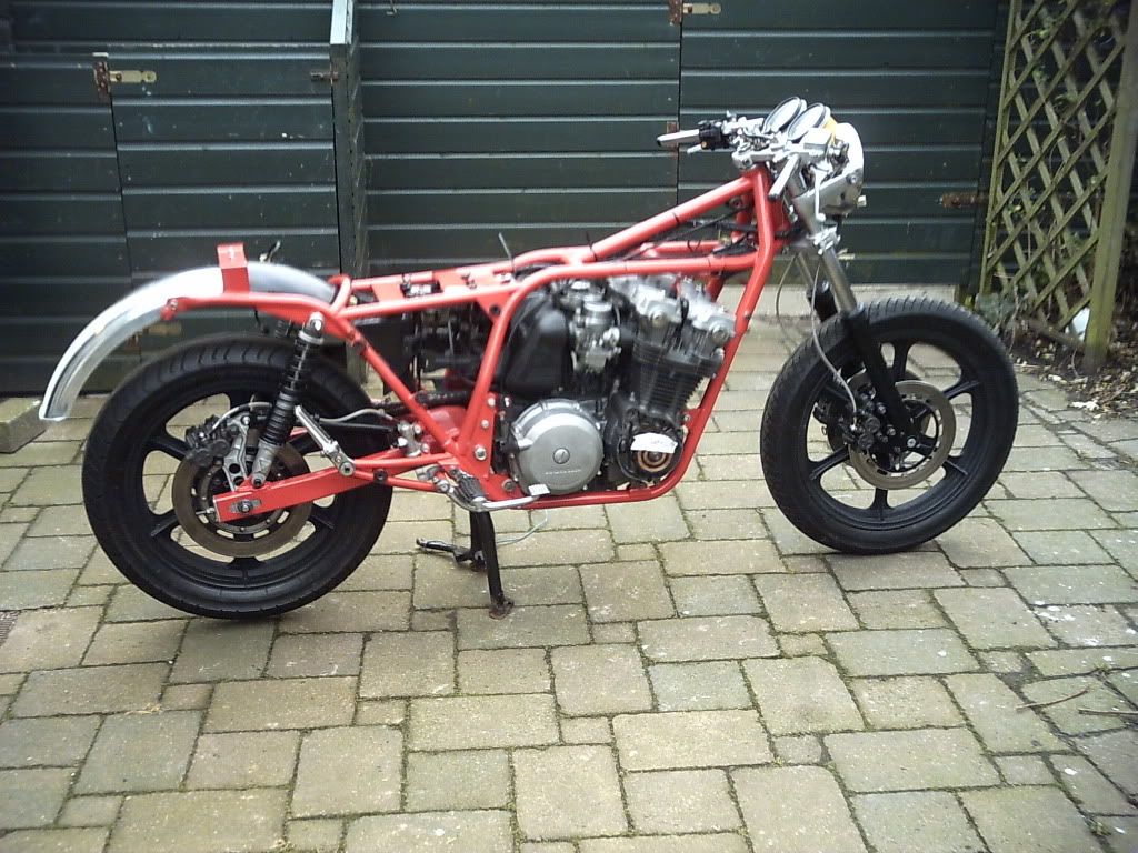

Yesterday, I completed the front end and put on the wiring and front brakes ( of a CBX 750 new pistons, seals and pads ). I'm still looking for a right front fender and still doubt about the rearlight. What do you think of the old-cb rearlight???? ( and my new barn ??)

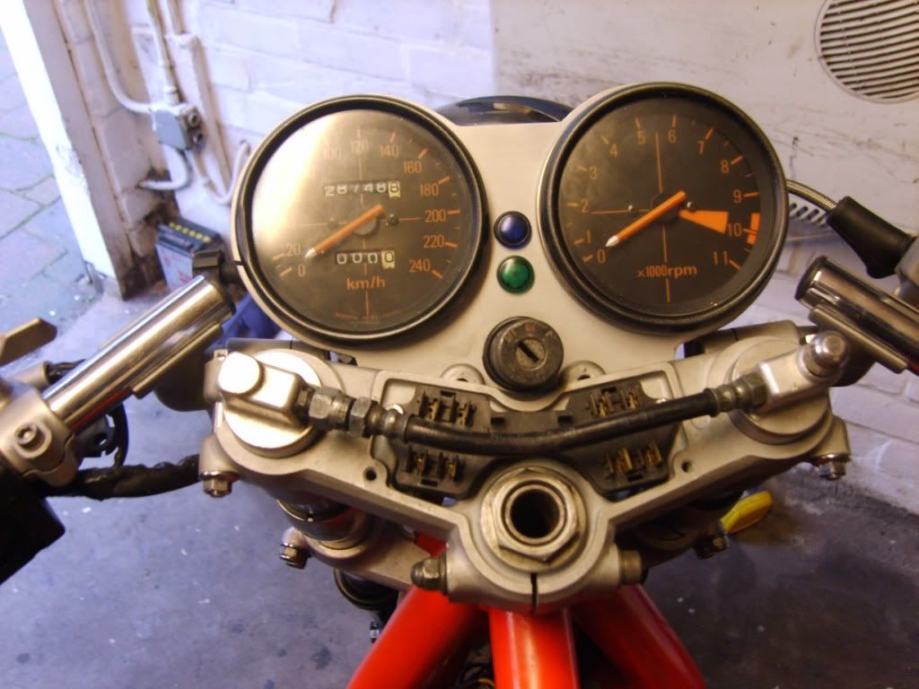

I had some time for my bikes this month, and the temprature is very nice, even outside. I made a alu plate for the couters. Glass blasted it, the same I dit with the engine covers. The contact lock have to be replaced, the same counts for the ugly hose of the air assistance of the front fork. I'm still looking for a nice front fender in alu or rvs. Sorry for the bad picture, its time for a new camera.
