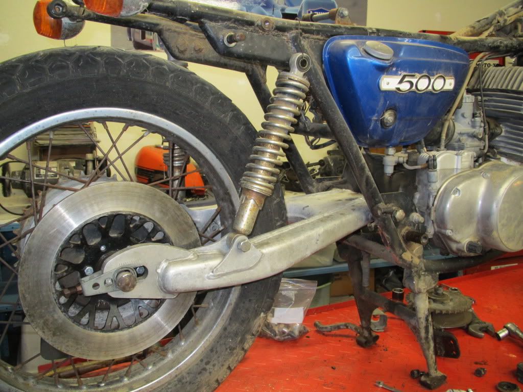

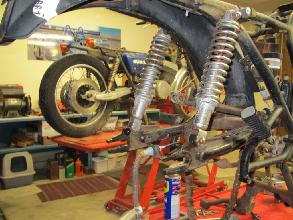

I have a few T500 cores, this one was sitting and i dont ride it much, so I thought I'd see if any of the ideas I had would work.
Always on the lookout to see if Suzuki parts will interchange, i was looking for an aluminum rr arm, and tried one off Rm250, it fit.

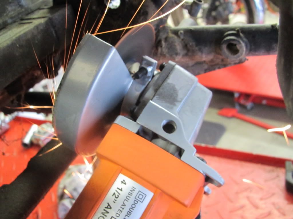

had to cut original muffler brackets off, but plan on using rr sets from something more modern, take-offs easily found on ebay, maybe GS500.
I would like to keep the wire wheel look, but want to use more modern brakes, and had a rusty GS750 core which i got mainly because it had the wire wheels, and it looks like it will fit, need to get the right wheel bearings to use the 17mm axle, plan on using an aluminum rim, new spokes.
still lots of work to do, would like to find a dual disk brake from early eighties Gs550 or Gs650, or similar, suggestions welcome.
so this is a start, i usually dont have much time or enthusiasm, but with Cafe Racer TV program getting me mojo working, I would like to try and get somethings done on this, hope to post more later, thx for looking.
