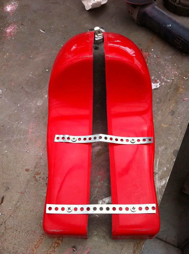

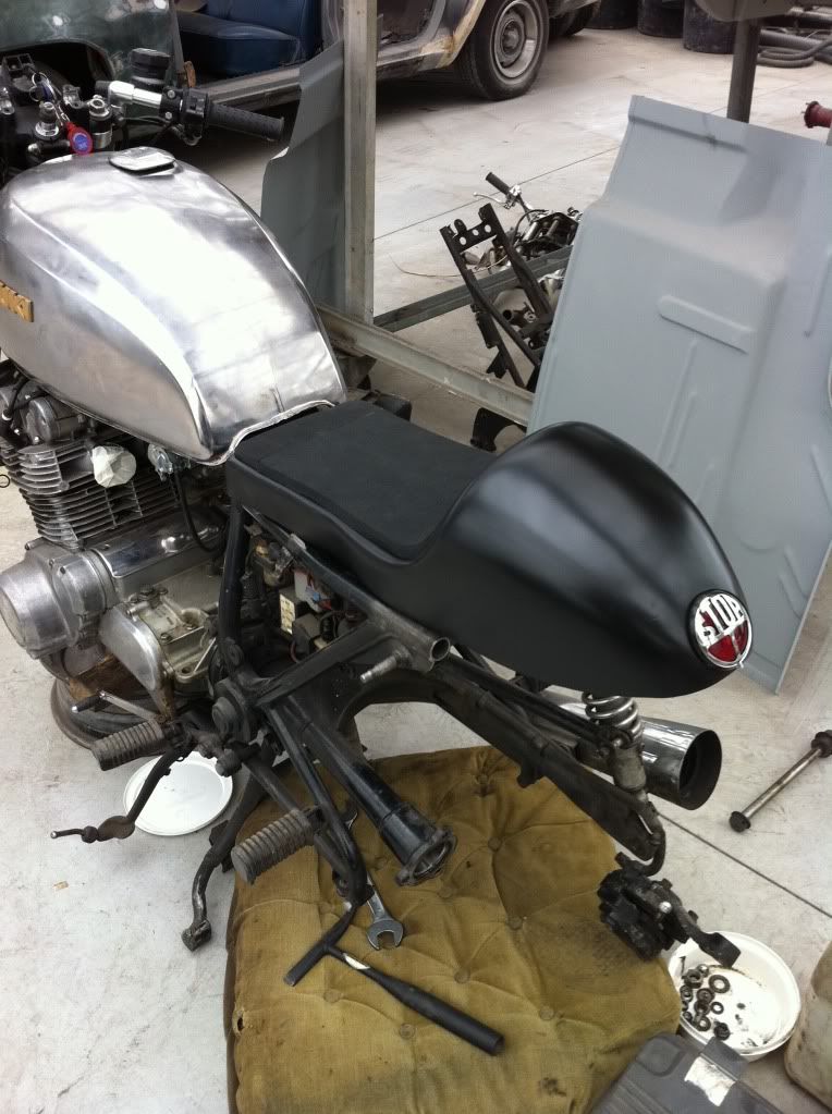

here are some pics of the 1979 suzuki GS 850 that was given to me by a guy who got tired of it! didn't wanna go all out as this is my first bike-project, just wanted it to look badass and wanted to drive it ASAP!
just in!
strippin' what we won't be needin'...
bling!
seatcover too short and too narrow...
rejetting!
K&N!
Bridgestone BT45

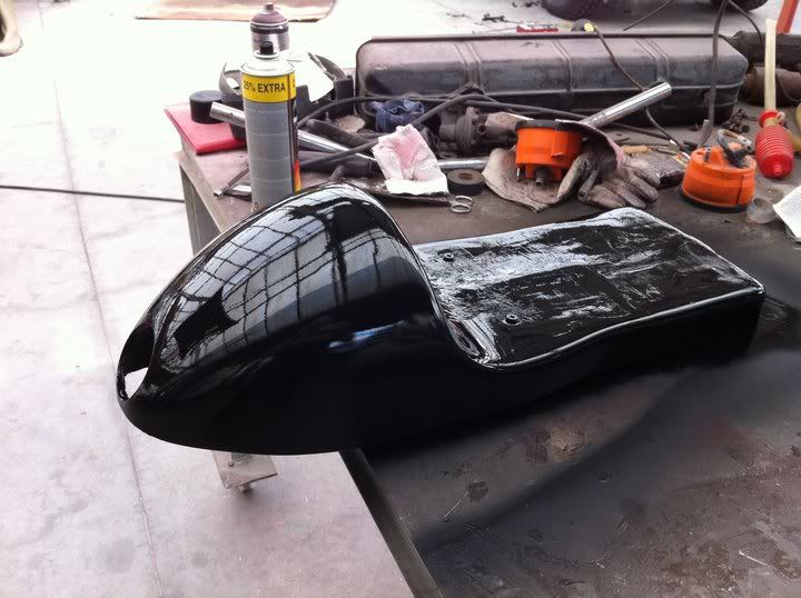

the seat:
Millertime!
almost there:

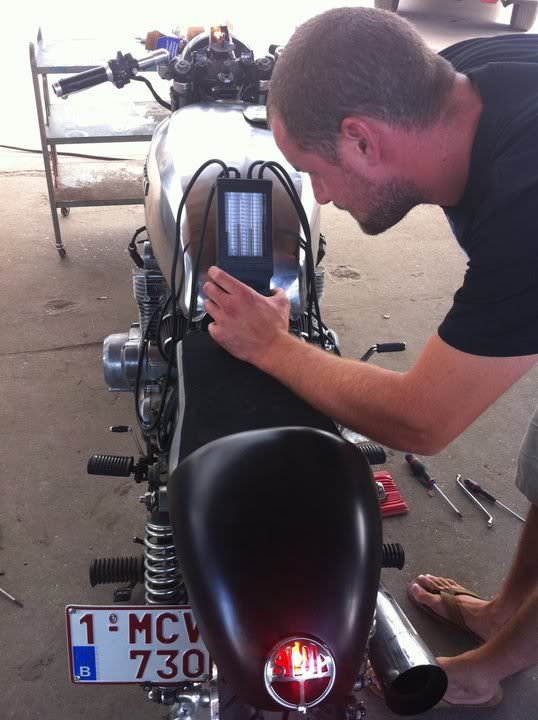

synchro!

i have never seen a synchro like that , does it work wih lights or something ?
Re: GS850 "MadMax"
Post  GS850 on Wed 22 Feb - 12:21
Toecutter wrote:Nice looking bike man ,
not really, it uses metal rods that slide up and down in a plastic tube using the vacuum. works great!

but about that power... when i had it, it was driving solid, but after placing the K&N's and gutting the exhaust, it wasn't runnin so smooth... i put new jets, 1 size bigger, got me a synchro device and with a little fidling here and there it's running now, but when i open the throttle, on high rpm it's struggling... i'm gonna do a spark-colour test soon, see what's up and also, on idle it seems to linger in higher rpm's a bit before it goes down to the normal idle rpm, but i learned now that's probably because there's a vacuum leak somewhere...
