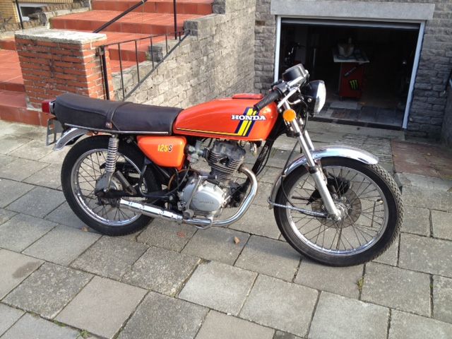

Post  suzukiac50 on Sun 16 Sep - 19:14

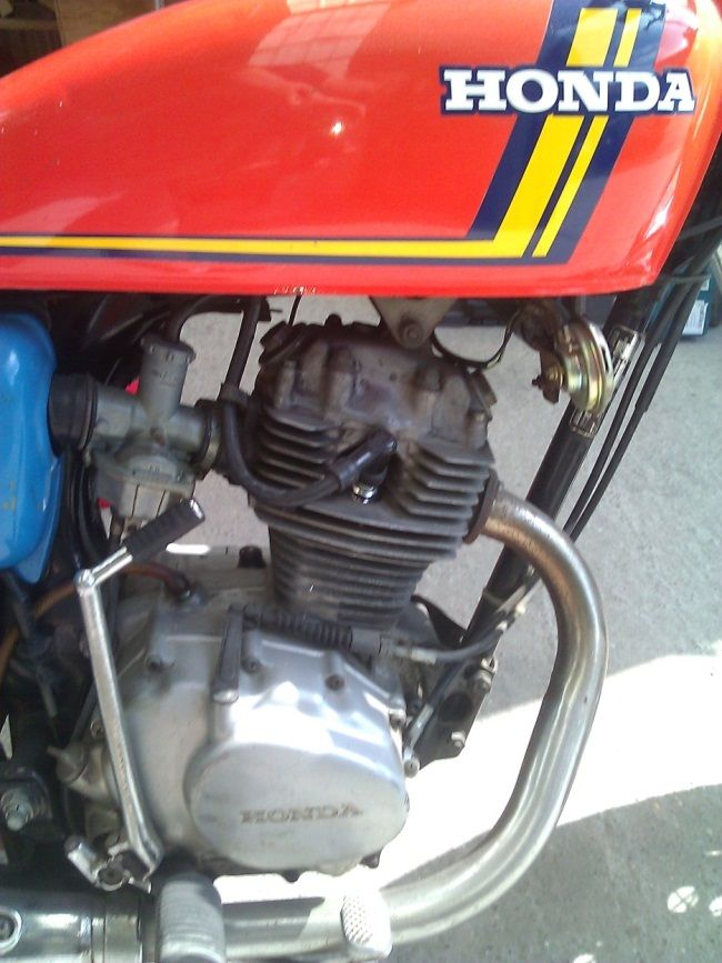

hello,
let me introduce to you my Honda CB125.
When I was 16,I was really liked bikes from 60's and 70's so I bought my first bike: Suzuki AC50 1977!
I loved his bike and it's cafe racer looks (I still do),therefor it was the inspiration for my next purchase.
So when I got in contact with a guy from antwerp who was selling his CB125,in went to take a look!
It was a beautifull bike,the perfect follow-up for my suzuki.
The bike was in good condition for my project,and I wanted it from the moment I saw it.
1 problem:the enigine did not run but the otherwise good condition,all the spare parts and ofcourse the price made me decide to buy the bike!
Here it is: The Honda CB125 1978
More info will follow!!

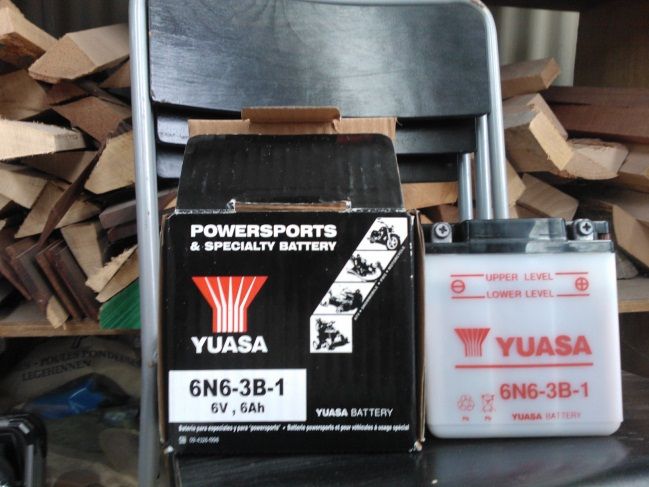

First of all i checked the basics to see why it wouldn't start.
Is there compression? YES
does the carburator get fuel? YES
Is the a spark? NO

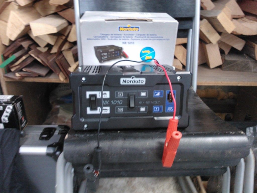

I looked at the ignition,when i found the first problem: the battery was flat so i bought a 6v charger and a new battery if the battery appears to be broken.
Also the Head fuse needed to be replaced,after that I adjusted the platines and i had a spark!! Very Happy

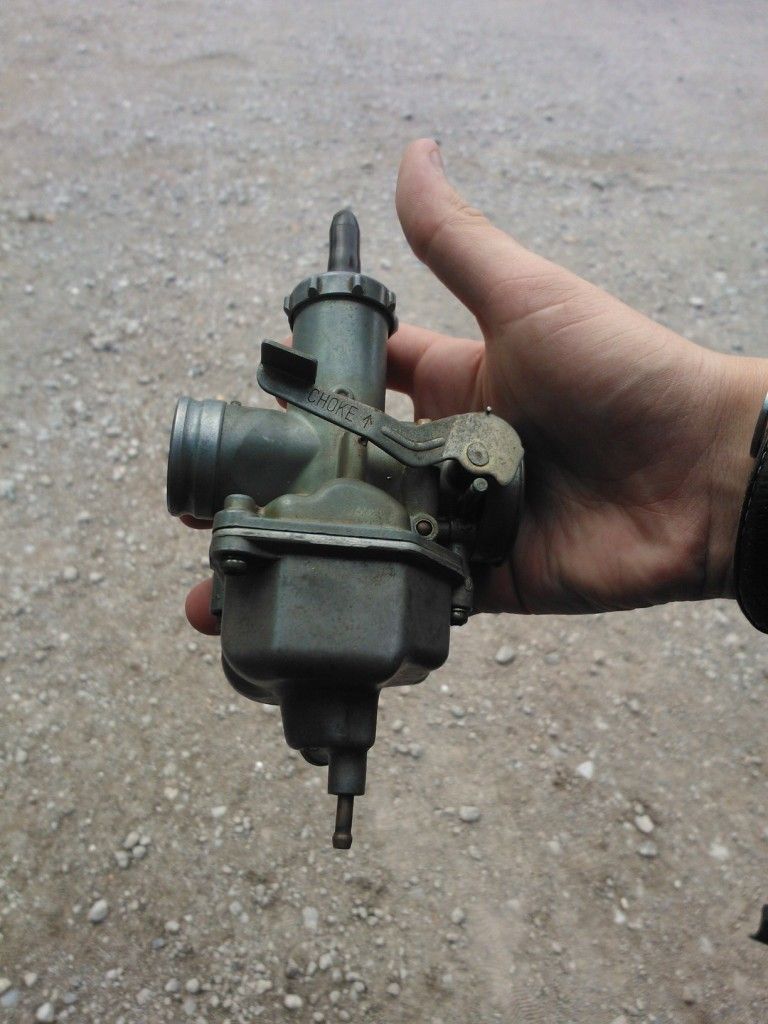

After kicking a few times I got the bike running but than appeared the next problem.
The fuel leaked from my carburator like crazy.
Luckely with the spare parts I got, there was another carburator that I cleaned and put together!
Now the engine is running and there is no more fuel leak! Very Happy

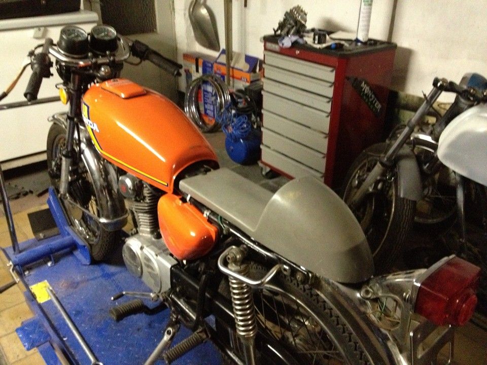

Post  suzukiac50 on Mon 5 Nov - 0:44
finally got my new handlebars on and i think it's looking good! :)
Went 'seat-shopping' this week,tried it on to have a look! It needs some modification but it is nice to see how it will look and i'm looking forward to see it when it's done!! :-) another taillight is needed with this seat!!

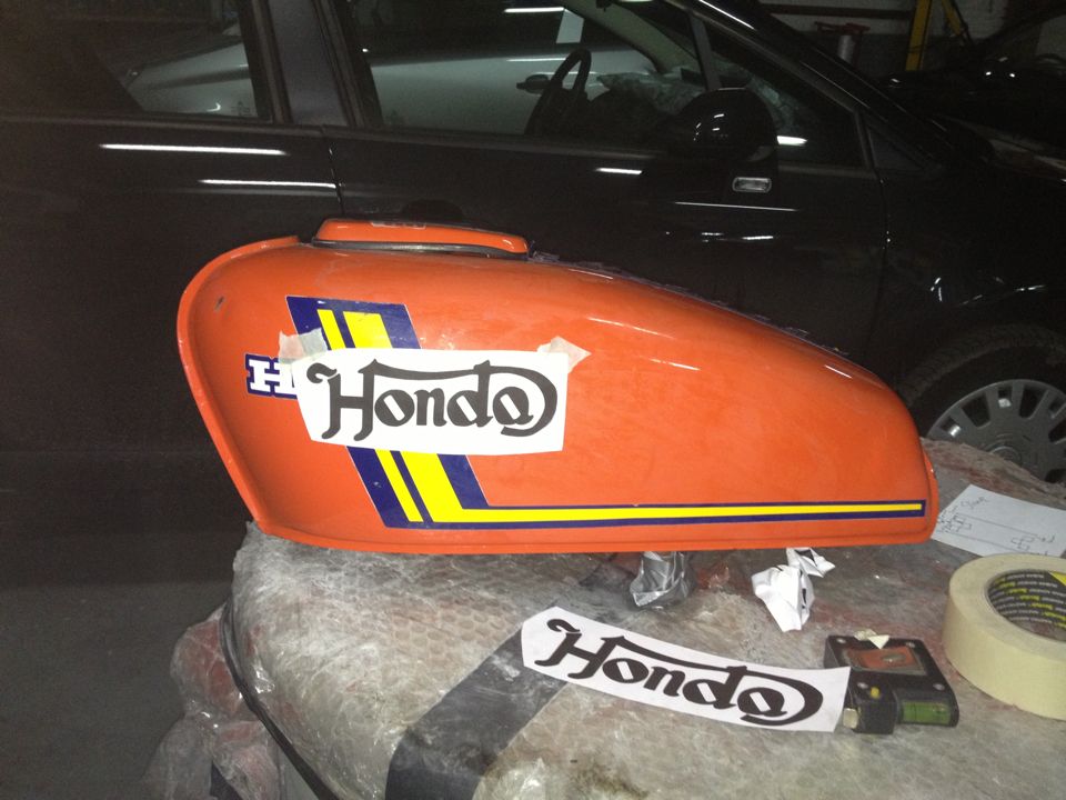

Post  suzukiac50 on Sun 2 Dec - 22:02
A new update:
When i brought my seat to get it spraypainted,i decided to paint the tank aswell!
It will be a the original colour,but with a new design!
What do you think!
The honda logo in Norton Lettertype,looks nice i think
The checkers wil be more straight ofcourse :-) and the blue line will be black aswell,and it wil be all over the tank and the seat!
any remarks?

Re: Honda CB 125
Post  suzukiac50 on Wed 5 Dec - 13:09
NEW STICKER DESIGN!!!!

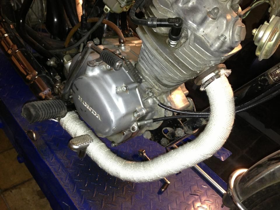

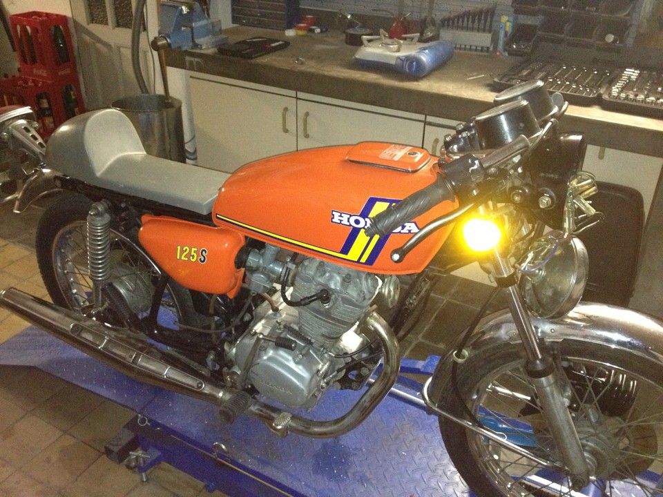

Post  suzukiac50 on Thu 17 Jan - 16:49
Parts are at the paintshop,stickers on the way,new led rearlight ready to be installed...
In the spare time 'installed' the exhaust wrap and started to polish engine covers! :-)
(the engine cover on the pic isn't done yet! ;-) )

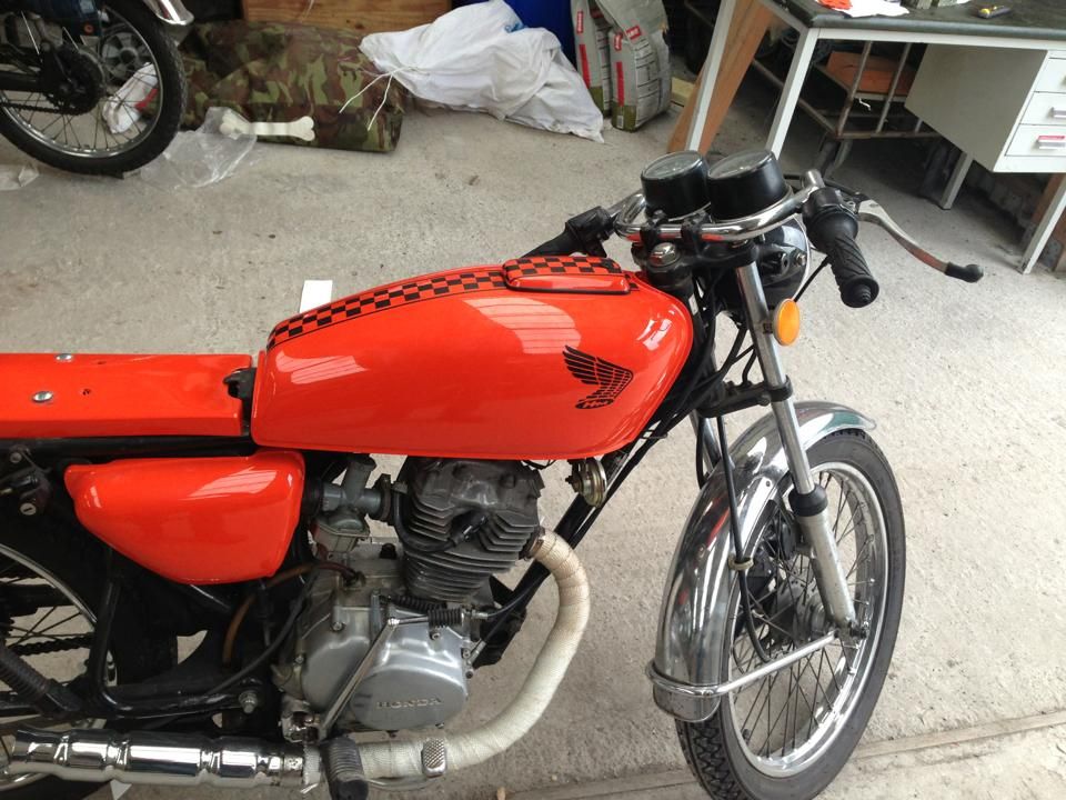

Post  suzukiac50 on Mon 11 Feb - 11:08
Everything is back from the painter and an is mounted back on the bike.
Just a few more details that have to be done like the stickers,the rearlight and the upholstry for the seat.

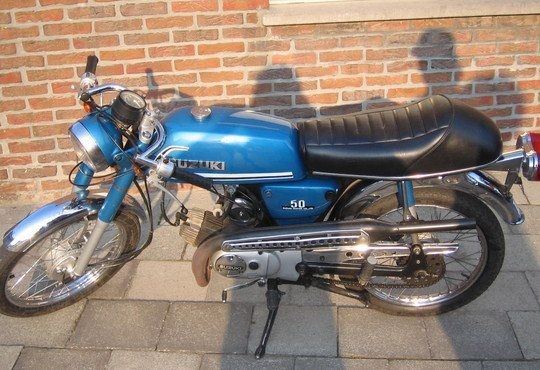

Post  marc 63 on Thu 14 Feb - 22:02
Great job on the cb mate .
a have a question for you. where did you buy the ac50 ? I think that is a project i did a few years ago for my son. He sold the ac50 afterwards to a guy from Watervliet. It's completely the same ac50 . Notice the not original blinkers , the mudguard at the front and the color differance on the chain cover.
i made this bike as a replica from my own ac50 when a was young :-)
greetz Marc
marc 63
Join date : 2009-02-16
Re: Honda CB 125
Post  suzukiac50 on Thu 14 Feb - 22:47
Aha Marc,and here we meet again,i have the bike for almost 7years now and i will never ever sell it! :-)
That suzuki changed my life! It will be an example for al my future bikes and introduced me into the world of cafe racers!! I want to thank you for that,you did an excellent job!!!
