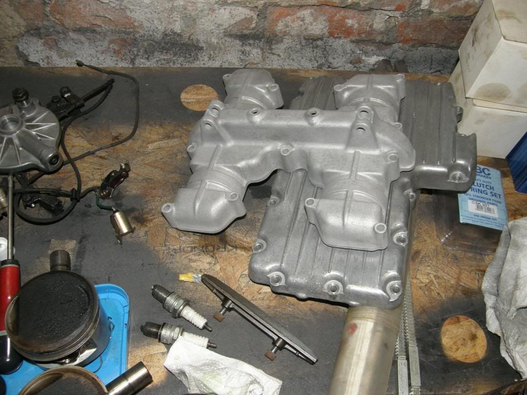

I am leaving the frame and bodywork alone until I finished the engine, so just some pics of the engine for now.
Waiting for the clutch and oilfilter to arrive before I can close the sides.

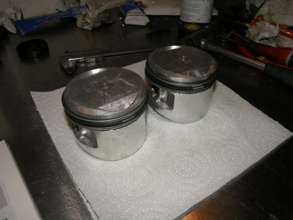

A brand new pair of pistons, scored on ebay really cheap
The rest of the engine, they get cleaned tomorrow

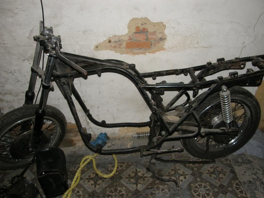

The rest of the bike, looks sorry right now. It'll need a lot of work, as the tank and seat are too narrow for the frame + I want to hide the battery and electrics, use modern rearsets...

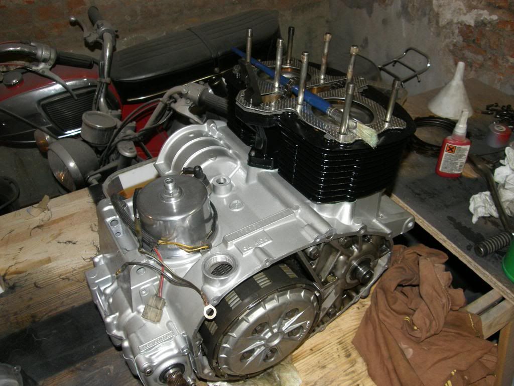

Post  abarth850 on Sat 12 Jan - 21:17
Some progress, Installed the new pistons, cleaned and painted the cylinder jug, fitted the clutch with new plates and heavy duty springs.

The cilinder head is on, as are the camshafts.
Drilled some holes in the pinion cover.
Sandblasted the cam cover.
And because the engine is almost complete, started work on the forks.
Once the temperature is up in my garage, i can paint the last pieces of the engine...
