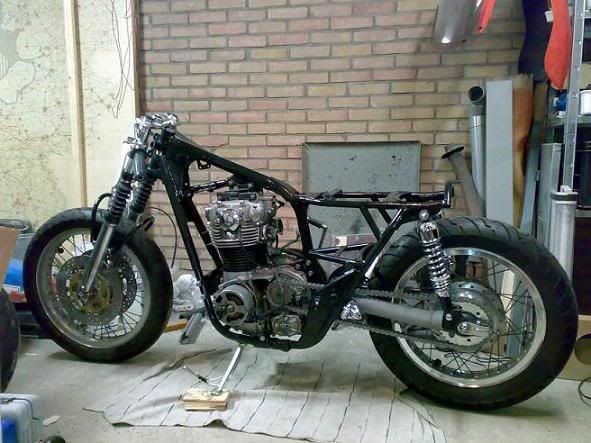

I started this project as a project for school. I built a frame for it.
After a few years I found the XS back in the garage and thought to sell it or finish it. It became a finishing project.
Due to dificult approval laws I decided to by a dutch frame with plate. The donorbike was imported from USA so the original frame was discarded.

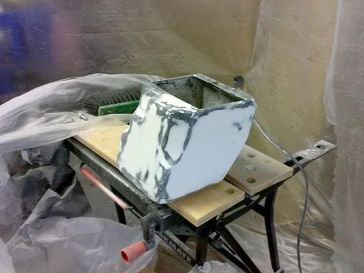

I made a seat and bought a polyester Manx tank but found the tank to small.

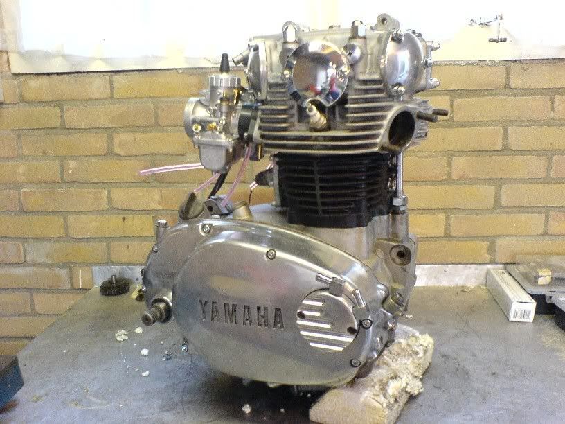

I rebuild the engine with ea. 710cc kit, racing camshaft, and other carbs. Also other parts as conrods, valves including springs, bearings and oilpump were placed new.
After an update of the frame it was powdercoated semi gloss black.

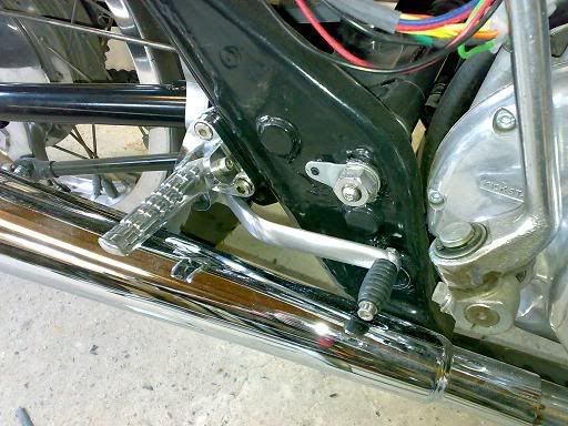

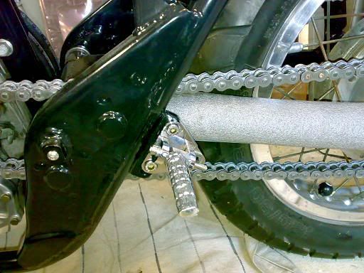

I made brackets for the steps.
The rearbrakepedal is made to still use the kickstarter but the steps must be foulded up before start. The electric startermotor is removed to make room for a external oilfilterkit bought by Heiden tuning.

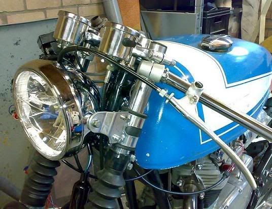

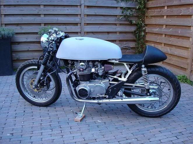

I bought a Read titan tank that was used on a CB500F racer. Also a clear headlight with the classic shape.
Clipons are from Tarozzi. Neat and clean construction in limited space. The new speedo is in MPH to remember the bike started in the USA.
The bike at his first day outside the garage.

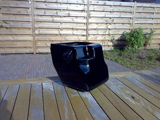

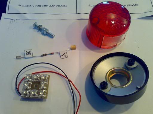

I want a clean rearlight so bought the smallest I could find and modyfied it to remove the bulb and place a LED light.

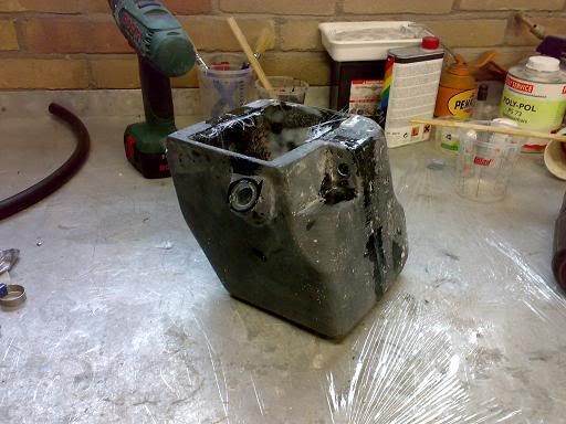

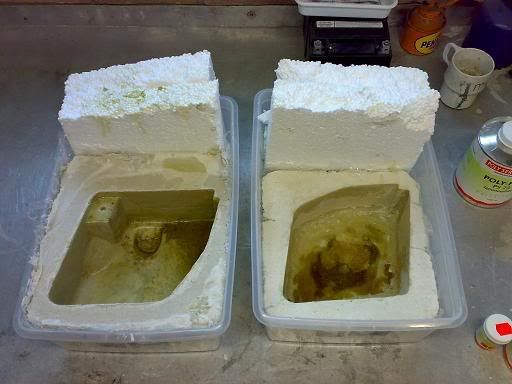

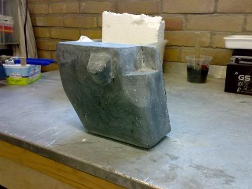

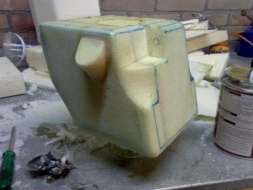

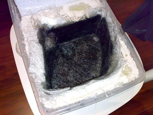

To place the battery I built a dummy oiltank. I used the oiltank of a Honda CR750 as example with filling cap and oilline inlet. The oilline inlet is a one-way airline kit also from Heiden tuning.
Now it looks like this:
It's fun to drive and get lots of compliments. That's nice after the lots of work!

but i have a question.
what size of front rim is that?
café cb500f
Join date : 2008-08-19
Re: XS650 caferacer
Post  XS710 on Fri 22 Aug - 19:34
The frontrim is just the original 19" one. The rear is also original 18".

At the first picture a seat is shown that I made myself. But due to the number of imperfections I desided to purchase a nice new seat.
I have bought the polyester base of the seat from Harrie vd Kruijs. I have modified it a bit for a better line and fitment on the bike to reseave the same line as I was trying with my own made seat. After that it is padded with a layer of foam and finished with skai. (fake lether that can resist wether/sun) It's very uncomvertable but hey, all for the looks.
