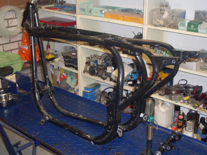

Post  mooner on Fri 16 Oct - 12:19
Hi everybody,
Today it was a nice day to take the Triton apart and start making it my own bike.In a few hours it was done and this is the result.
Hopefully the progress is going wel but i'm affraid it's going to take a bit longer than a few hours Rolling Eyes
[url][/url]
I'll show more pictures when everything (sandblasting,powdercoating etc)is done.
grtz Simon

Re: Triton '51
Post  andreas on Fri 16 Oct - 23:06
Hi mooner,
yuo are a lucky boy - this is a really good basic to rebuild. Have some fun on "screwing it to a new live".
Wait for more pics
