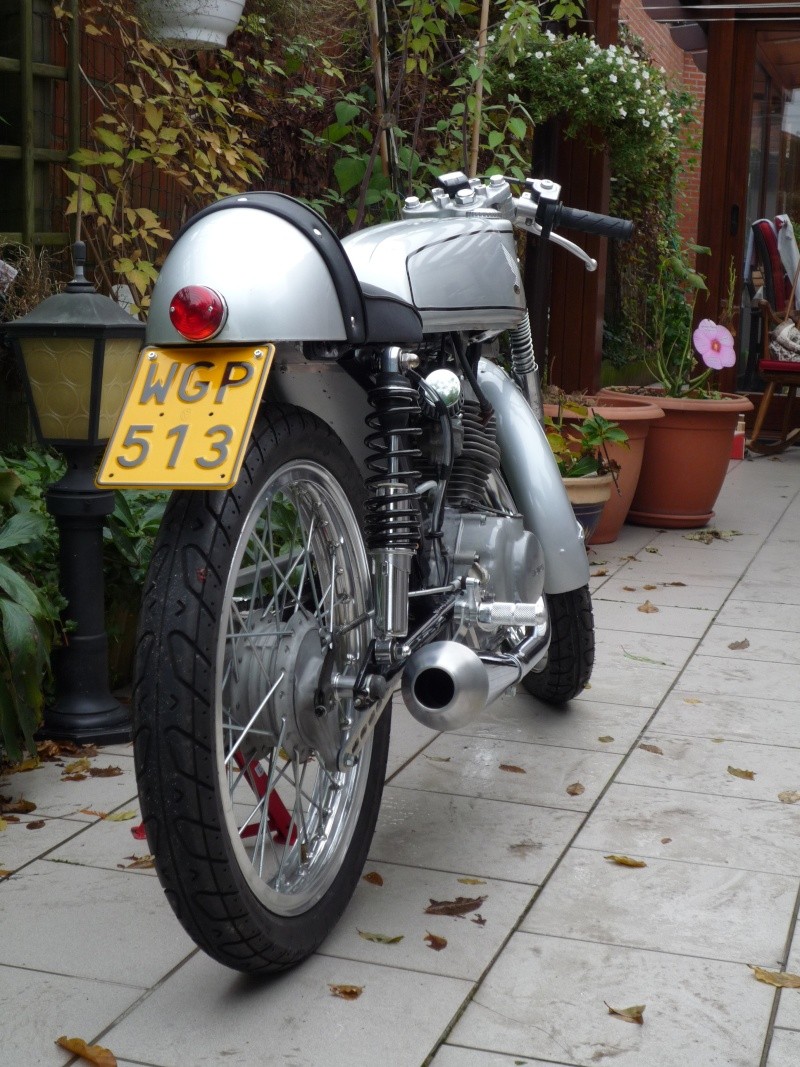

Post  blue blitz on Thu 12 Nov - 20:55
Some pictures of the current state. Have some holiday this week so could spend some time on my bike.
I modified another rear set to fit the cb125 so which works with the new exhaust. The megaton diden't really make it more silent but chrome looks better anyway.
Since the last pictures I put some lights on it and temporary bicycle speedo.
There is still a lot of work to be done. I want to put an alluminium front fender and polish a lot of the alloy parts.
But next is to fit a side stand (bought one today that is normally intended for a scooter) but needs some rewelding which I can only do at work.
Notice that the bike doesen't have a kickstarter. Since it was previously intended for racing the axle hole was closed by welding. I can tell you this is just as good as going to the gym. Still thinking about putting a kick if I can get it to fit (I have a spare clutch cover).
Fixing the dent in the fueltank is also on my whishlist.
Anyway here are the pics...
