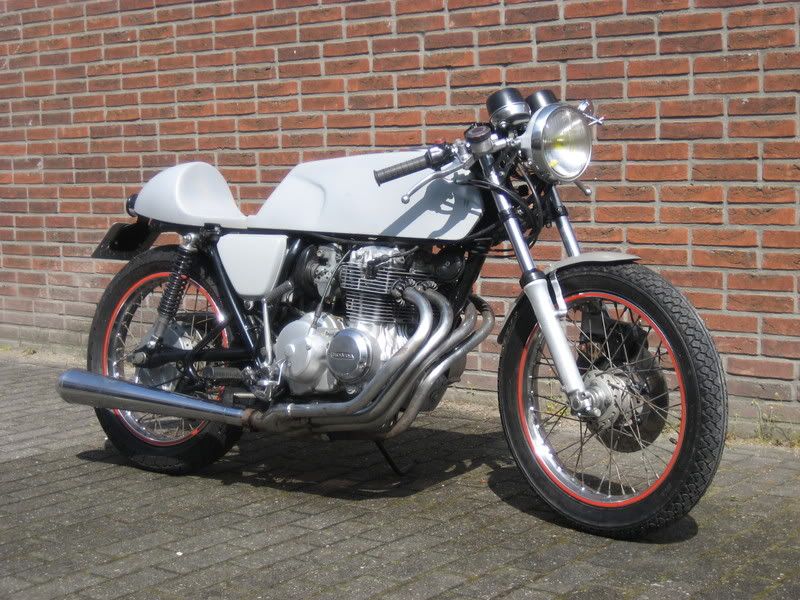

I'm building up a cb400Four from scratch to racer.
It all began with 6 boxes, two frames and 4 wheels.
The idea was building one cb400f, the cash needed for building one would come from selling the parts which I didn't need. Laughing (That's what I told my wife Razz )
After surfing on the internet, I came up with the idea of building a caferacer.
When I was building, I met a former racedriver who still makes tanks, seatcover and stuff.
Then I came up with the idea of making a streetlegal classicracer.
Now I will show you the latest pics,
As we speak the tank, seat and fender are prepared and will be painted one of these days.
Last week I also placed other springs on the back.
The original were to short, I've replaced them for a set springs from a CB900 Bol d'or.
Please sit back and enjoy,
Comment is more then welcome.
Ton up folks: :face:
This is how it began...a friend of mine offered me to coat a frame for free...
Ofcourse I couldn't say no, but from that point I knew the bike must be proper build to become a pretty bike.
One with a X-factor.
Re-shape the head bracket, into my style..
Just bought a wrong tank on Ebay, too BIG :face:
Then I found a nice one, but needed in and outside work.
Making a right the tank fit on the frame....

Yes you did a great job ...nice work! Is the collor going to stay like this ?
jocolor
caferacer 1975
Posts : 315
Location : utrecht
Re: CB400Four Cafe/Classic racer
Post  tjeeke on Wed 28 May - 22:28
Thank you, thank you. Embarassed
The colour will be Ford Focus ST Electric Orange:

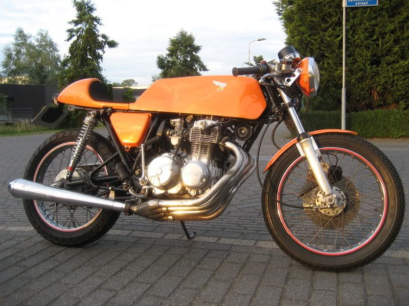

Post  tjeeke on Mon 7 Jul - 23:38
Finally she's done....
Yesterday I made it to Achterveld and nearly back home.
Just 1 kilometre from home, the bike stopped.
I think the altenator.
But the piccas are made......

Post  Rooie Ben on Mon 7 Jul - 23:41
Die fiets is in het echt nog veel mooier dan op de plaatjes
Zou alleen die rode bies op de velgen eraf halen , maar dat is mijn mening , verder gewoon een supergave fiets hoor Wink
Die Dunstall clipons passen trouwens best aardig hoor Cool

Rooie Ben wrote:Die fiets is in het echt nog veel mooier dan op de plaatjes
Yep. klopt!

Post  Wout on Wed 9 Jul - 13:31
Mooie caféracer. Ik deel wel de mening van Rooie Ben, wat betreft de oranje lijn op de velgen.
Heb je de kroonplaat zelf gemaakt? Of heb je de bestaande aangepast?

Post  650zed on Wed 9 Jul - 14:08
Okay, maybe they're right and the orange lines are not exactly necessary...
Still: you got yourself a great bike!
I saw it also, in Achterveld. I was impressed.

Post  caferacer 1975 on Wed 9 Jul - 19:16
ja hoor prachtige motorfiets...
Moet alleen rooie ben gelijk geven over de rode rand op de velg...past beter bij een matzwarte..

Post  sonicsurfer on Sun 13 Jul - 0:39
Mooi gedaan hoor, chapeau!
Die rode rand vindt ik wel een beetje storend bij het oranje. Mischien is het wel erg mooi om de velgen zwart te laten poedercoaten, of een setje alu velgen op de kop tikken!

Post  tjeeke on Sat 19 Jul - 23:47
Gelukkig lees ik niets als lof over mijn rode rimstriping...... affraid
Het zal mijn zieke geest wel zijn die ze mooi vind.
Ik ben natuurlijk ook een "Kruikenzeiker" (<-- lees "Tilburger"). Very Happy

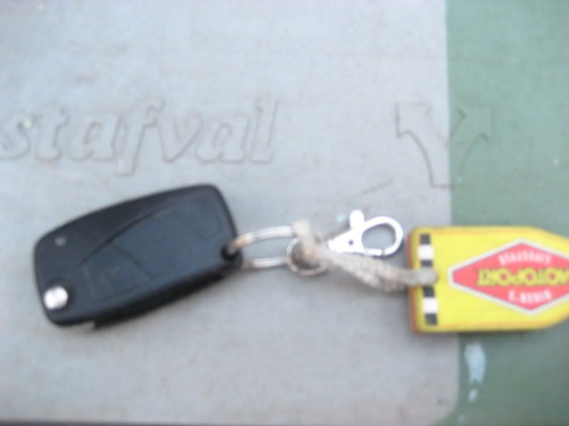

Nu dat de motor zo goed als klaar is, dan toch maar eens de schuur opruimen.
Vaak kom je dan leuke vergeten onderdelen tegen....
Dit is toch zo'n VW-klapsleutel geval.....
Ja, toch?
Nee, dus.
Na een halfuur vijlen en zagen is het voortaan een Honda-klapsleutel
Ik heb alleen nog geen bestemming gevonden voor de druk knoppen op de sleutel.
Mogelijk eens kijken of ik er een zaklampie van kan brouwen. confused

Post  caferacer 1975 on Sun 20 Jul - 1:22
handig handig....

Post  Rooie Ben on Sun 20 Jul - 22:51
Macgyver is er niks bij Razz Razz
Post  tjeeke on Sun 20 Jul - 23:00
Rooie Ben wrote:Macgyver is er niks bij Razz Razz
Tsjaa, als ik wil, dan maak ik van een scheet, een kneedbom... cheers

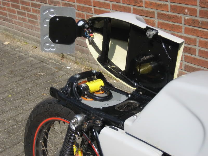

Post  Mingh on Wed 23 Jul - 22:04
Bit like this one, but i'd place the license plate a bit more to the inside, such that the bulb to illuminate the license plate can be hidden under and inside the tail.
Mingh
