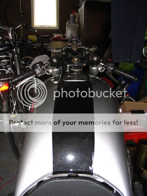

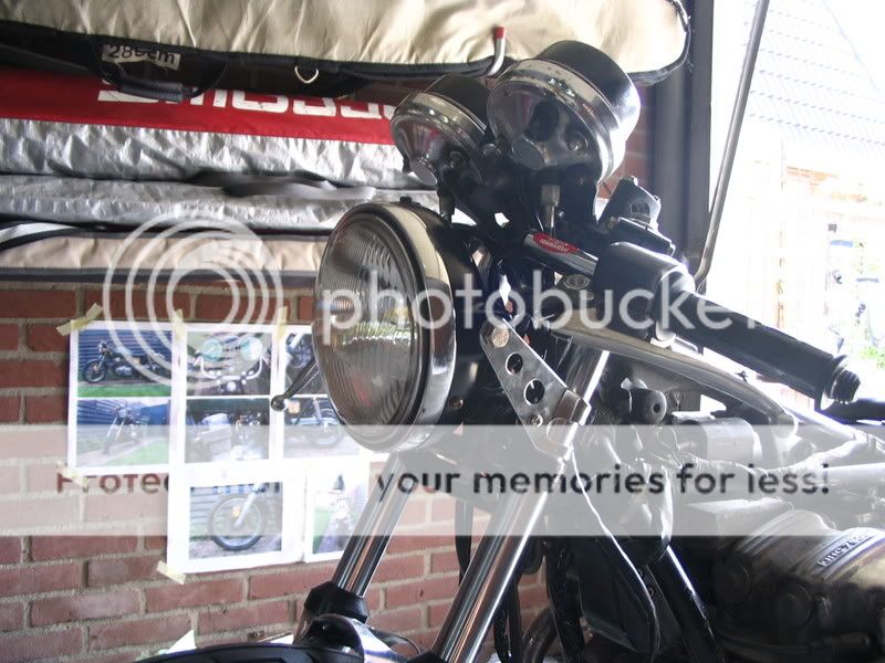

The front fender could be a little bit smaller.
The forks are polished
Clip-ons
Headlight brackets

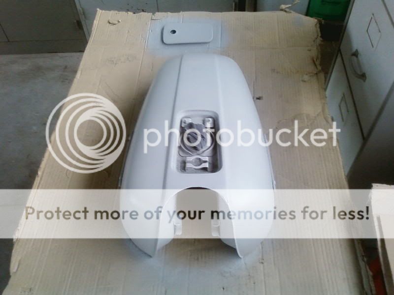

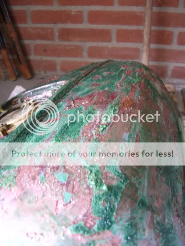

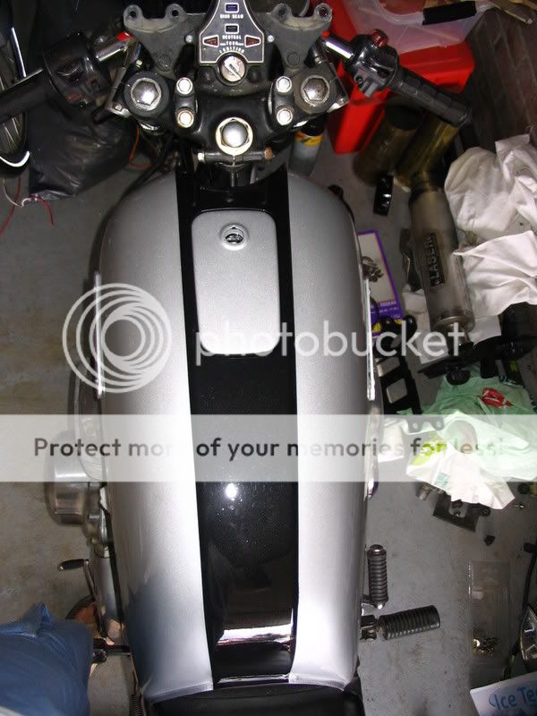

The tank and front fender could use another colour.
First taking off all the old shit.
Then a nice primar.
End then te finishing touch.

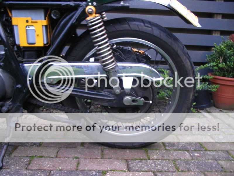

Post  Hofman on Sat 10 Jan - 18:53

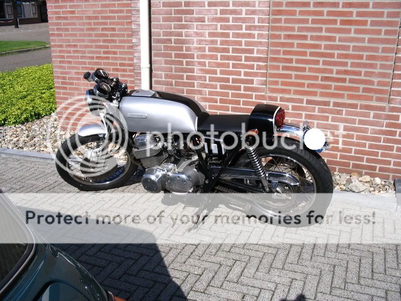

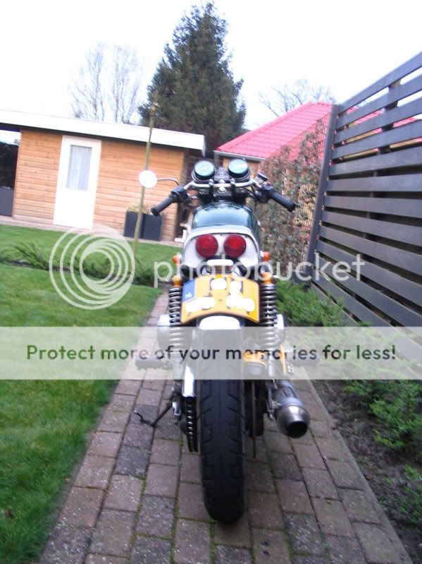

Below some pictures as I ride it last summer.
There where three different kinds of spark plugs in the engine, so I replaced all 4 plugs for new ones (to good ones).
One off the spark plug cables was broken en repared with a nail and some tape!!! Hahaha.
New coils would cost me to much, so I welded it back together.
Because I now had clip-ons the original brakelever would not fit with the resevoir. So I bought a second hand (original Yamaha R6?)
with an external reservoir.

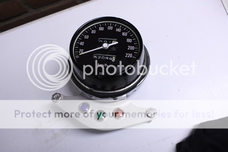

The clocks had a green background. I didn't liked it and I saw that that American guy (cb750cafe.com) sold other backgrounds. On his site he discribes how you should do it. After that I made my own background in black. If let them print at a proffesional sticker company in my place.
I have one set extra made. So if anyone wants them? Diameter is almost 90 mm. I can print more of them, and mayby also with a white background.
Things I have done for the summer off 2008
- secondhand contactswitch
- other brakelines
- New tires
- New brakepads
- New oil and filter
Now the bike was "safe" to ride with.
The big test was a weekend to Reddighausen, Germany. That was 216 km.
There I found out the bike used al little bit off oil Very Happy
Nobody wanted to ride behind me.
A revision would cost me to much money. So I keep riding this way.

Niceeeeeeeeee I like the taillight and seat Cool

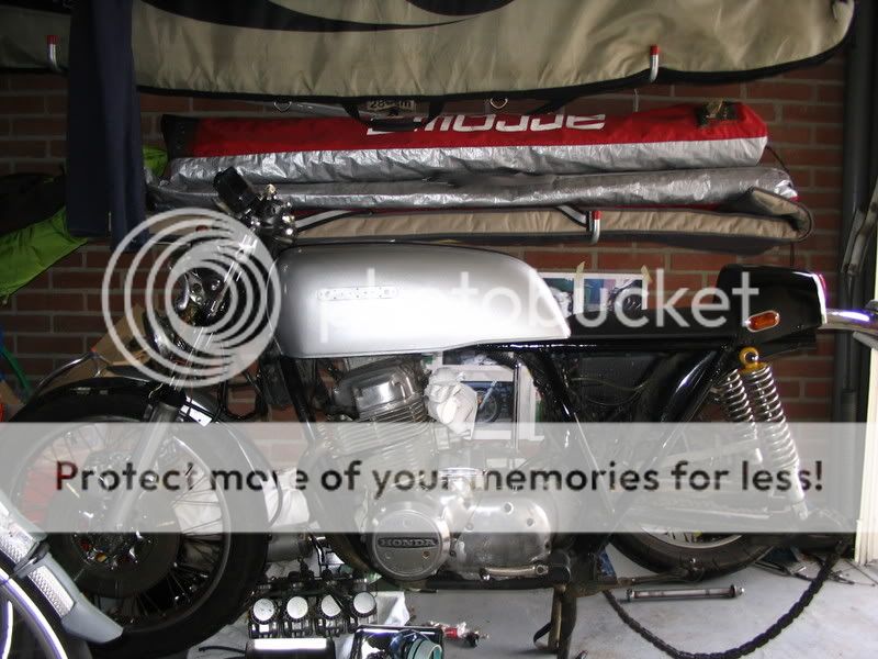

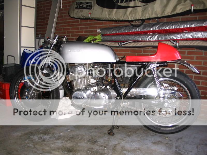

This winter the bike has gone through a lot of changes.

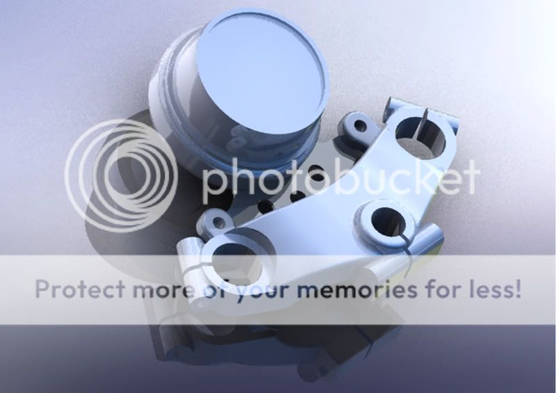

I wanted one clock on my bike and no electra on my clip-ons.
I sanded the handlebar holders and the mounting for the contact switch away so I had a very clean upper fork top bridge.
First I draw something on the computer, then I made it from wood and then I send it to a lasercutter.
I found a small gashandle on a show in Hardenberg. It was from a Honda crosser??

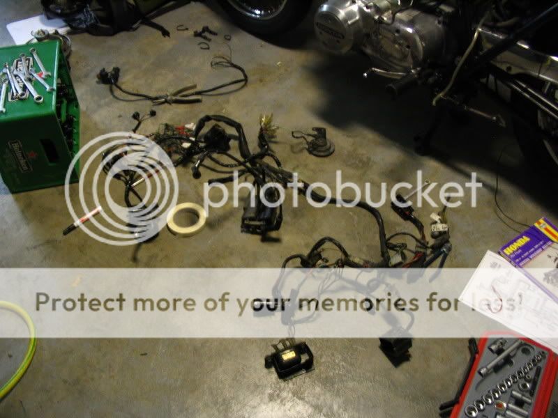

I made a compleet new wiringloom. The emergency stop, turnsignals, lightswitch, horn etc. could all be removed so it was a very small and simple wiringloom. The normal light will burn when I turn the switch and a switch for highbeam is mounted in the back of the headlight. The contactswitch and the electric starter are moved to underneath the seat. Also a new fuseholder (with new type car fuses) and a small scooter battery (old 4.2 kg, new 2.1 kg)
The old wiringloom
The new battery holder
A look at the contactswitch and starter.

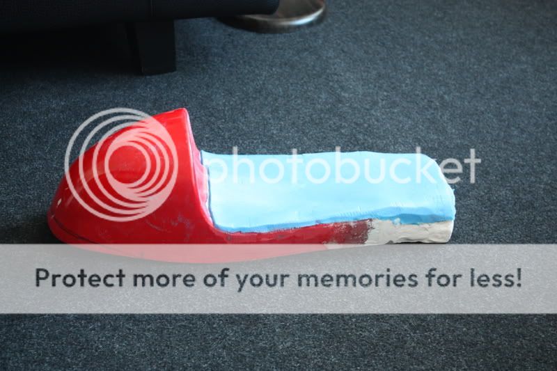

A new seat, was to short
Adjusted with some polyester.
The seat i now being away for some leather and a red line.
Original Raask set and the brakes I have drilled holes in.

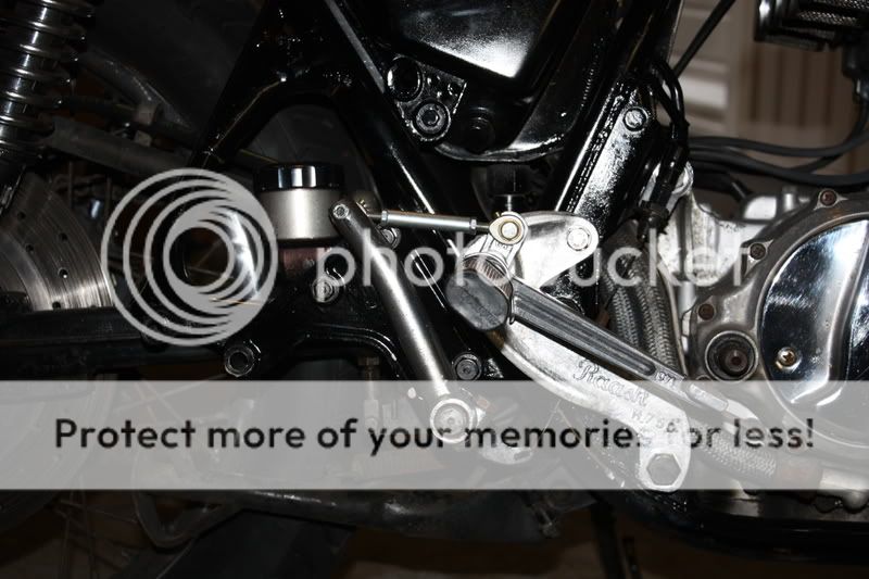

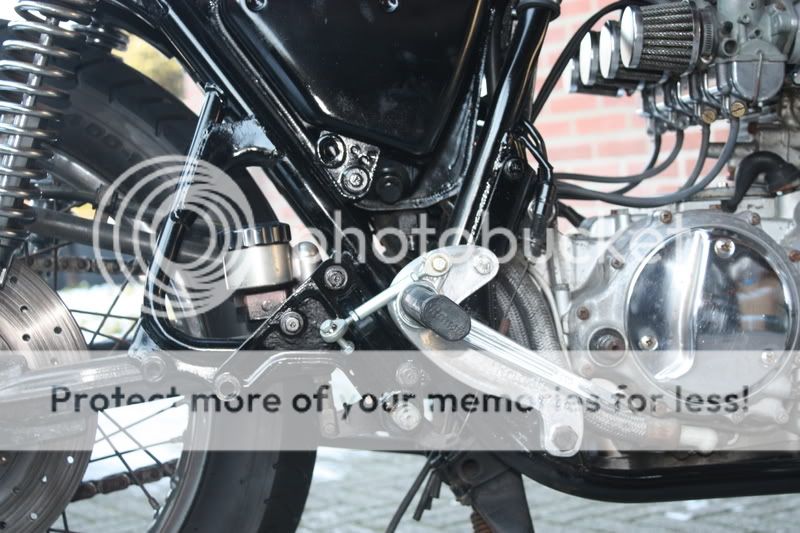

Here are some photo's of how I connect the brakepedal.
I have a question to: I can't use my kickstarter, because the footpeg is standing out. Has anybody any ideas?

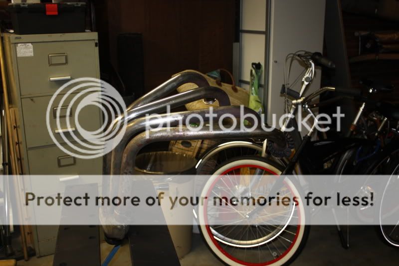

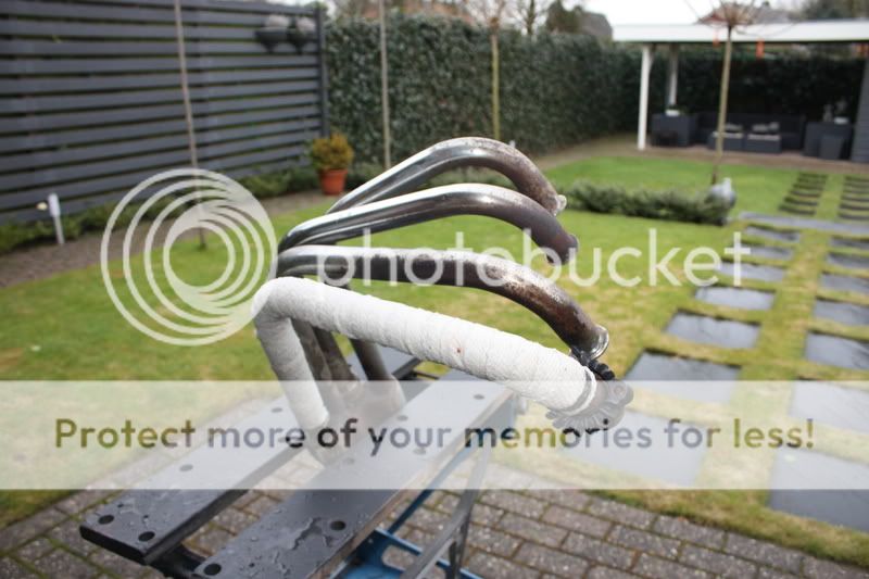

I'm working on the exhaust to. Not finished, because I need to order some extra heatwrap.

Good idea on sorting out the brakepart of the rearcontrols. Might just copy that of you, though I have a plan of my own which I'll try first just to not copy anybody. Wink
Also like the exhaust wrap, how much of the exhaust are you wrapping in the lint?
About the kickstart, there are foldable stands out there, perhaps it's possible to replace your rigid one with one of those?

Damn, i forgot to measure the lint before a wraped it around.
I order some extra wrap this week. I will measure the next exhaust pipe.

What kind of heatwrap is it? I bought some cheap crap to use it on my moped but it started to burn Sad
Re: Dutch Honda CB 750F1 caferacer
Post  Hofman on Sun 25 Jan - 18:16
The heatwrap I bought is from this guy: erik fanchamps (efanchamps@hotmail.com)
For the Dutch guys: ga naar marktplaats.nl en type daar in: uitlaat tape. Dan kom je er vanzelf.
It is the real stuff. Dit not start the engine yet, but I know it will produce a lot of smoke Very Happy
I measured the length for one exhaust tube: it is 3,5 meters. This is when you put a half tape over the other.
so you will need to order 2 x 10 meters if the width is 50 mm.
This is the result:

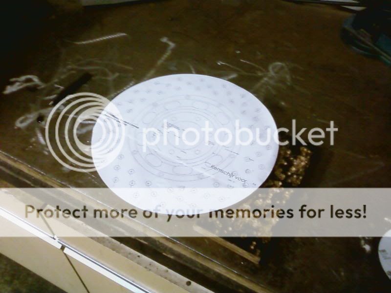

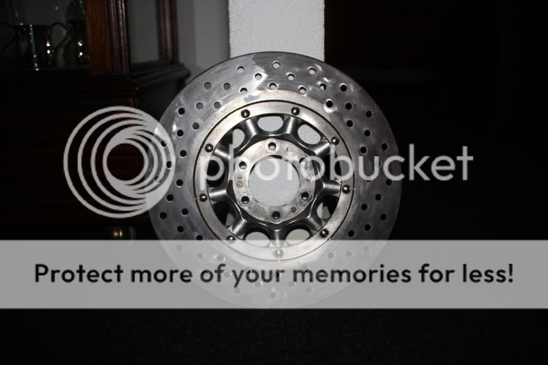

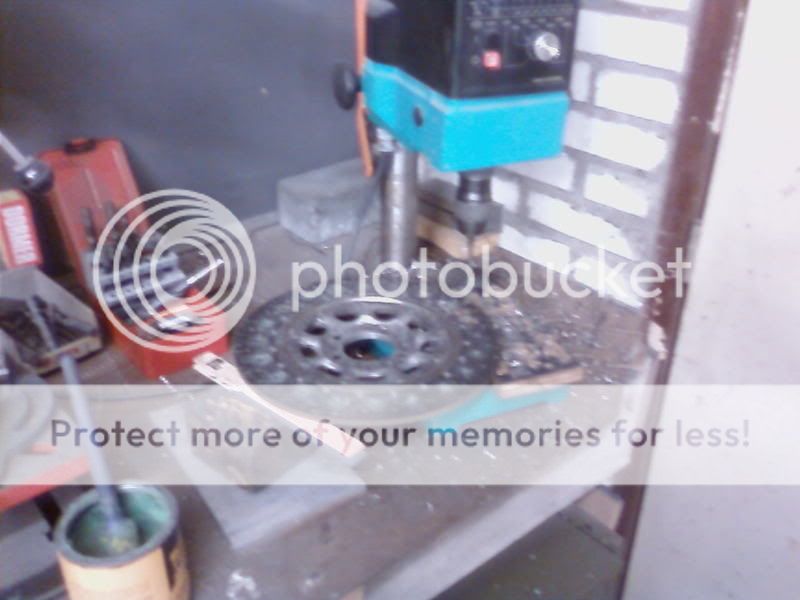

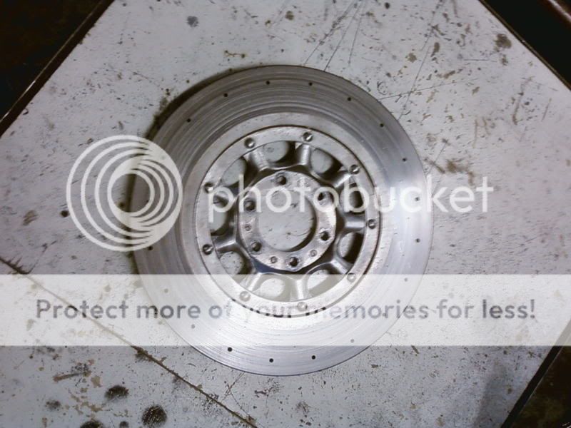

I also finished the front end. I drilled a lot of holes in my front brakedisc. First I made a drawin on the computer. Printed this 1:1 en layed in on the discbrake. Then with a centerpoint mark all the centers of the holes en begin with drilling. First 3 or 4 mm en then 8 mm.
