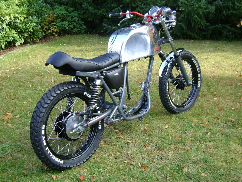

Post  andreas on Mon 5 Oct - 15:47
Hi guys, time to come up in the long list of special bikes. You know the story - i change now the direction. I build this SR into a scrambler, and number three into a racer ( comming soon). In the next weeks you can see it also on my homepage www.retrospeedstyle.de.
So here you get a small update - change the wheelbase other seat and more black parts combinated with polish aluminum and some "red spots". Wintertime is perfect for prepare the motor. I use a "normalpower" 500 motor with a little bit upgrade like exhaust, air intake and carb. So i mean this is ok for the tires ( arround 40HP). The racer will get a max. power motor, and i think the bike will be only for racetrack. At the moment i prepare the frame and clean him from all "no needing" parts. Many things to do, so next month you can see more.

Hi folks, short update, change once more again the direction. I think the green ( Absynthgreen from Citroen ) is perfect for a scrambler - smaller gastank also. I will take away all red parts and use them for another bike and change to black. Rebuild clearglas headlamp.Next weeks i rebuild the brake system. Hope i get the motor fit this winter. Now i "jump" in my garage to take away the complet ceiling and replace it with more light and white colour - so better for working.

Post  alazzurra 550 alu style on Sat 12 Dec - 14:35
very very nice, the color combination is perfect. like the green very much, and i'm always pleased to see your clean work.
one thing, i would make the front fender in the same color as te frame, bud thats my opinion, bud again very very nice bike.

Post  kornfed on Sat 12 Dec - 16:30
much better Andreas, very nice colour and tank.
I'm curious about the exhaustideas for the scrambler.

Post  Rafe56 on Sat 12 Dec - 18:52
looks great,
black rims will also be on my kawa with stainless steel spokes.
Are they black chromed or sprayed high gloss or powdercoated??

Hi Rafe 56 - all parts are powdercoated - old alu rims, first sandblasted - than two times powder ( black/clear )
